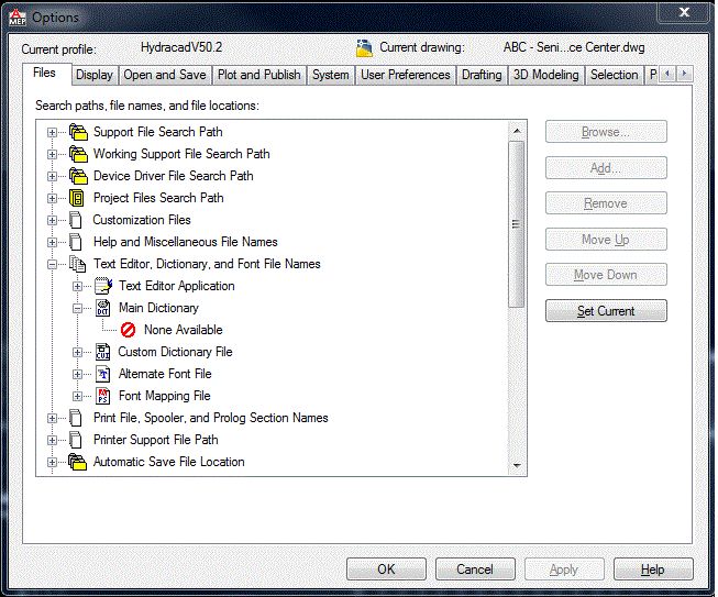

Same problem but none of the fixes are working. I found the *dct files. However when I go to "Options-Files-Text Editor, Dictionary, and Font Files-Main Dictionary" I get what is shown below. Notice that Browse, Add etc. are greyed out. Doesn't matter where I put the *.dct files if I can't set the path in config.
Any ideas?
1568i73CB958598D23478
Message 10 of 27
Bob.Felton
in reply to: Anonymous
Since you have the profile 'HydracadV50.2' loaded, try loading 'AutoCAD MEP (US Imperial)' to see if that restores access to the dictionary file.
If that works, then you might want to check with HydraCAD support to ask why their profile is turning off access to the dictionary and spelling when their profile is loaded.

in reply to: Bob.Felton
Tried that but it didn't make any difference.
