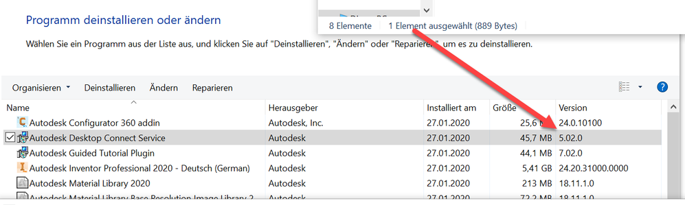

okay can you please make a screenshot of your "uninstall programs" dialog so that we can see which version you have installed:
And can you please also check if you have this folder:
regards

Looks like I dont have Autodesk Desktop Connect Service
Also, I do have the AutoDesk Desktop Connect folder, however nothing comes up when I type in "forever" in the file path.
