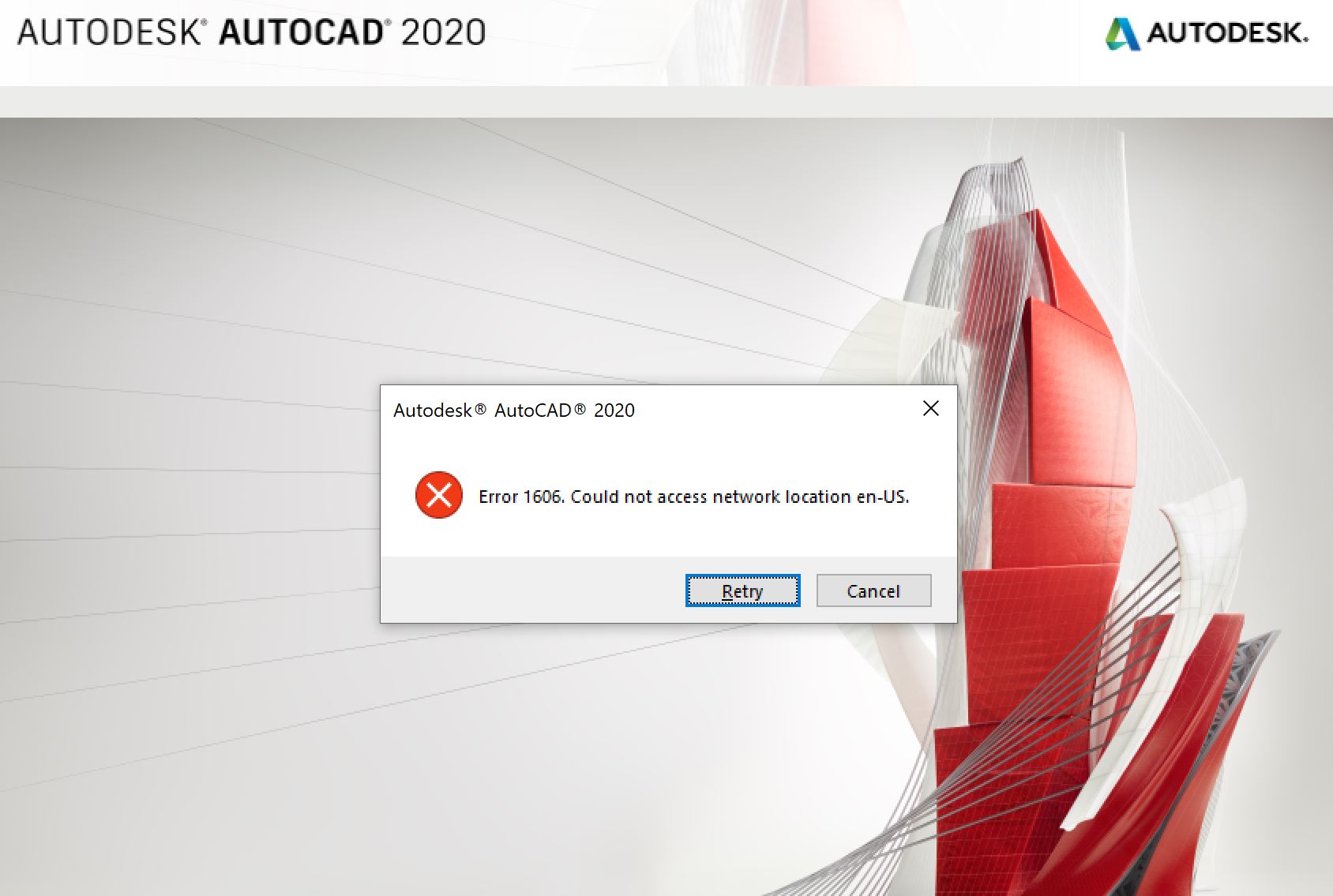

How do I fix this? I pretty much tried everything like checking my internet, my registry editor, Network and Sharing Center, and etc. From everything I tried "Error 1606. Could not access network location en-US." keeps popping up and that basically stopped me from downloading the software. So what can I do to fix that to download the software? Is there like a step by step to do this?

please do not use the "Install Now" option to install AutoCAD.
Instead use "Browser Download", wait until all downloads are finished, then turn off antivirus and start the exe as administrator (>>>details<<<).
