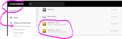

It's free with subscription too
Have you seen this tutorial on the topic including setup https://ketiv.com/blog/how-to-implement-autodesk-vault-basic/
DarrenP
no you don’t
