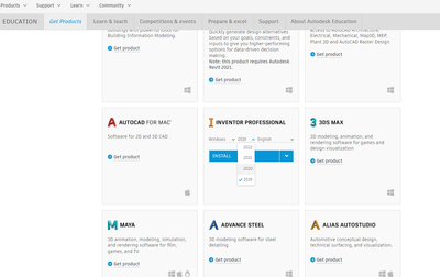

Hi @c.p.eskov,
You can get licenses from the portal dating back and including the 2019 version. Just make sure the license you have matches the install.
If you choose to use the browser download (multipart) you will need to disable your pop up blocker on browsers such as Chrome, you should get 3 parts.
If you want the 2019 Version, just select 2019 on the drop-down:
I agree that the process could be easier but it's what we have now.
