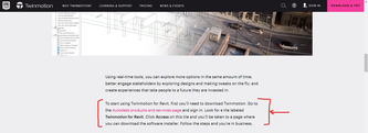

@Simon_Weel, You need to get Access to use Twinmotion..!!
Go to the Autodesk Products and Services page https://manage.autodesk.com/products and log in. Search for Twinmotion for Revit. Click Access and you will be taken to a page where you can download the software installer. Follow the steps go render.

@mdavis22569, Actually No. You have to access it separately.
The link that you shared also says the same.
And as I said earlier,
(https://www.twinmotion.com/en-US/news/twinmotion-for-revit-is-now-included-with-revit-subscriptions)
