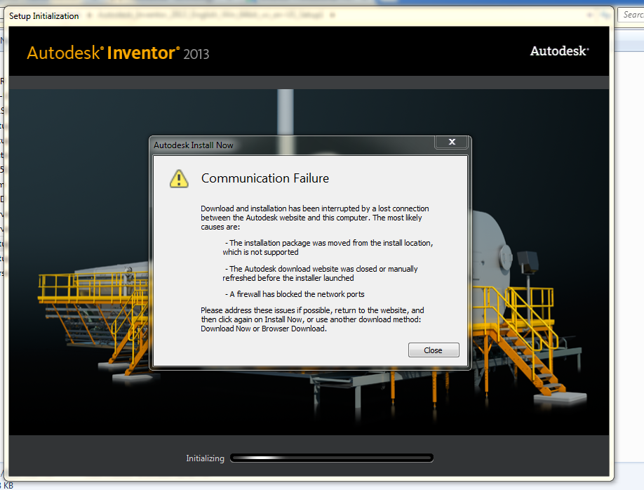

New Sager computer, Win 7 all updated, no virus software.
Revit 2013 downloads to default folders, c: autodesk for setup and downloads folder for exe,  but get Communication Faliure error when I run the exe.
Don't get what I'm doing wrong, not changing any folders, it should know how to install it self.  Yes, my interernet is on and working.
I have tried freshly downloading 3 times.  over 3 days incase server was wonky.  No firewall on this side.
Thank you, zowie

Hello Vinayak!
In this case the easiest workaround would be to utilize a different delivery method, specifically browser download.
You can access most current + previous supported version Browser Download links through Matt, our Virtual Assistant.
From Matt: Download and Installation -> Software Download Links -> I need to redownload my product

Communication Failure Issue Solved - Windows 8
back up windows files
restore windows 8 at restore point
uninstall restored maya from control panel
reinstall maya using download now
note:
downlowd now did not work prior to windws restore
So happy to have my Maya baby back, I felt like I was going to crash and burn without it !!!!!

This is my 1st post here, and I only joined because I had the same installation problem. I am an IT consultant and wanted to install Revit on a MacBook Pro under Parallels in a Win 7 environment for a client. I ran into the same problems as described in this thread.
What I then tried is to use IE 8, (later should be fine too) on Windows 7. I selected RUN instead of SAVE from the Autodesk download page and left IE open. It started the install, then Windows popped up a page asking for my permission to allow Akami through the firewall, to which I said yes.
This then progressed without the pesky error. I cancelled the final step when it said it needed over 8GB of space, and I am on an SSD with limited space. However it looked like it would have worked.
Hope this helps someone.

IE seemed to solve issues I was having.  For whatever reason, I was getting communication errors with Firefox, wasting all sorts of time.  Using Explorer, things ramped right up.

Browser downloaded it and it worked!

Download browser version and you will be done....
