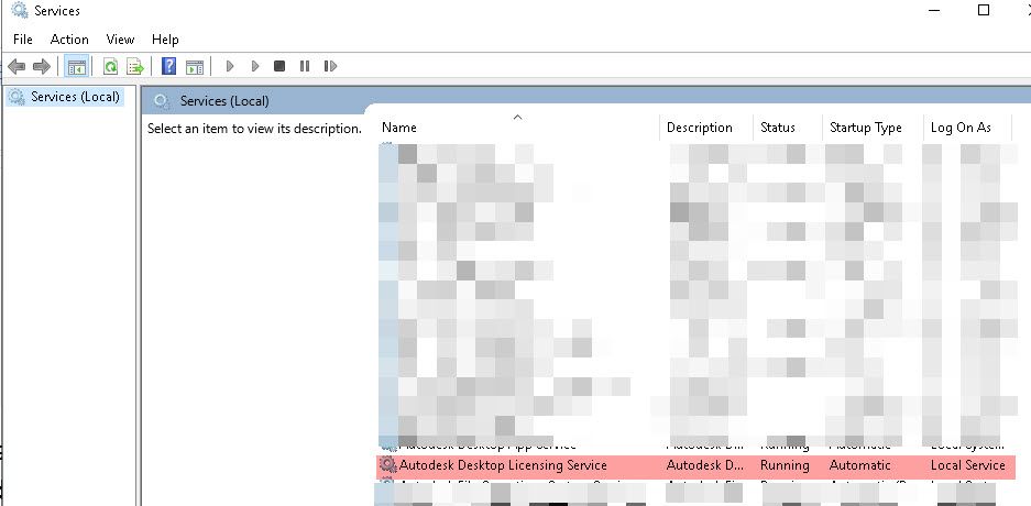

Confirm if this Windows service is there and running

I can confirm that the Licensing Service is running at the moment.
