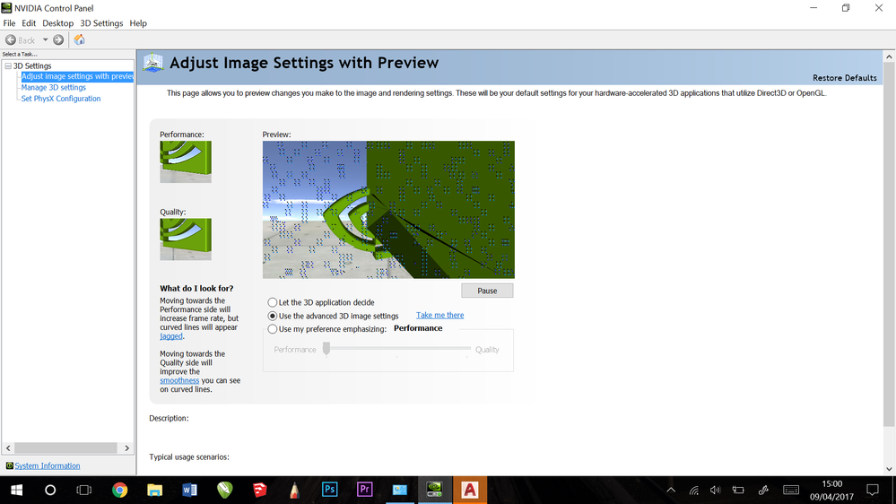

hi Mark , it never worked. I think the problem is graphic card look to attachment because i dont know how i can fix this problem.image.png

Mark.Lancaster
@Anonymous
Image doesn't really help...
What video card model do your have?
Have you followed the steps in the linked article?
Mark Lancaster
