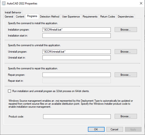

Here is what I had to do to get the whole suite working with SCCM.
1. Pull out the SCCM script from the install .bat file that is included and replace the network location with the local location and put this in its own batch script. ie.
"\\%network%\AutoCad2022\image\Installer.exe" -i deploy --offline_mode -q -o "\\%network%\AutoCad2022\image\Collection.xml" --installer_version "1.19.0.20"
  to
.\image\Installer.exe -i deploy --offline_mode -q -o .\image\SCCMCollection.xml --installer_version "1.19.0.20"
All of the Autodesk suite apps will accept the .\image\Installer.exe location in this batch script except for Inventor. You'll have to specify the paths so it looks like this:
%~dp0image\Installer.exe -i deploy --offline_mode -q -o %~dp0image\SCCMCollection.xml --installer_version "1.20.0.44"
You'll also want to do the same for the uninstall path, it will look like this(Create a different batch for uninstall):
"%network%\Mudbox2022\image\Installer.exe" -i uninstall -q --manifest "%network%\Mudbox2022\image\MBXPRO_2022_en-US\setup.xml"
to this:
.\image\Installer.exe -i uninstall -q --manifest .\image\MBXPRO_2022_en-US\setup.xml
2. In the image folders of each deployment, copy the Collection.xml and rename it to something else, I've renamed them to "SCCMCollection.xml". Now edit this to take out the network portions and replace it with the local paths you've set earlier above. You'll want to change both the <DeploymentImagePath> variable and the <LoggingSettings><Path> variable. Here's an example what they will look like:
 <DeploymentImagePath>.\image</DeploymentImagePath>
<LoggingSettings>
        <Logging>true</Logging>
        <Path>.\log\InventorPro2022.log</Path>
</LoggingSettings>
3. Repackage the dependencies that have been causing the stalling deployments. Take the Adodis-Installer.exe, ADSKLicensing, and ADSKApp(Autodesk Desktop App) from the included installers you've packaged. Keep in mind, if you've packaged the software on different days or after an update has gone out, the older software I mentioned above won't work with the newer Autodesk apps, you'll just get the same issues when the newer versions try to run.
You'll find these in the following locations(Or at least I did):
ADODIS-Installer.exe:
In your AutoCAD 2022 Folder
.\image\ODIS
ADSKLicensing-installer.exe:
.\image\ACD_2022_en-US\x86\Licensing
AdApplicationManager-installer.exe:
In your 3DS Max 2022 Folder
.\image\3DSMAX_2022_en-US\x86\ADSKAPP
You'll want to repackage ADODIS-Installer and AdApplicationManager-Installer with something like AdminStudio, as these both cannot run with the System context that SCCM uses to deploy applications.(This is where Autodesk has not done any testing, and it shows).
For the ADSKLicensing-Installer.exe, you can create an application in SCCM with the following switches:
"AdskLicensing-installer.exe" --mode unattended --unattendedmodeui none
For detection I've detected the version of the application .EXE located here(Not the best way for detection, but its all we have):
C:\Program Files (x86)\Common Files\Autodesk Shared\AdskLicensing\11.0.0.4854\AdskLicensingService\AdskLicensingService.exe
Add these into SCCM.
4. Because Autodesk refuses to spell out plainly what the MSI codes are for their deployments, we'll have to install the programs we want to use so we can grab the GUID of the applications.
Go ahead and install the 50+ GB of Autodesk Suite apps on a test machine(Takes like 3 hours) and run the following command using Powershell to grab all the MSI codes on your machine:
get-wmiobject Win32_Product | Sort-Object -Property Name |Format-Table IdentifyingNumber, Name, LocalPackage -AutoSize
You can then use these codes for detection for their corresponding deployments.
5. Go ahead and add your deployments into SCCM now and use the information you've gathered earlier. For the install and uninstall paths, add in your newly created batch scripts. For detection, add in your captured MSI codes from earlier.
It will look something like this:
6. You'll want to deploy the ADODIS-Installer, ADSKAPP and ADSKLicensing first before deploying your Autodesk deployments to your machines. You can either do this using dependencies in SCCM or using the application groups or both.
I've used application groups and added the dependencies in the first part of the group so they will install before the rest of the deployments that require them to run.
Make sure to test out this using REQUIRED deployments to your test collections as this will force the deployments to be installed via SYSTEM context which is where this all started..
I hope this helps some of you, because I've spent the last few weeks battling with this. We shouldn't need third party packaging software to deploy these applications. Autodesk has documentation on how to install the Autodesk suite through, but I don't think they even tested it fully.

@lhall.autodesk Thank you so much! This is exactly what I've been looking for! I manage software installs for a 20K+ student school district and I have always had to fight with the Autodesk installer to work in our SCCM environment. This new iteration takes the cake, though - definitely more convoluted than it needs to be. I've been saying for years that Autodesk has no idea how SCCM deploys applications, from dependency tracking and detections to the fact that everything needs to be able to install under NT_LocalSystem (SYSTEM)....it certainly shows. Autodesk please take note - this is nuts. Nobody uses Packages anymore!
Editing to add - why does just Inventor need to have the explicit current working directory specified? I fought with this myself for about a week before I tried changing the .\ to %~dp0 just for giggles - lo and behold, that was it. It's mental how these little things that Autodesk overlooks makes our job as software admins that much more difficult. Wastes our time and our client's/user's time.
Message 26 of 47
lhall.autodesk
@Anonymous I'm in the exact same boat as you, deploy to our CAD labs in the schools each year. Finally got the hang of deployments last year with their old system, but for some reason they decide to change it up on us. They definitely did not test this thoroughly at all!
I've no idea why Inventor needs the %~dp0. When I found that out I kinda chuckled to myself.
