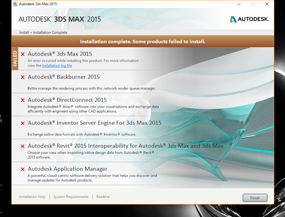

i cant install my 3ds max, i use to have it installed a while ago and removed due to not using i am now trying to install again and i keep getting this message, as in picture

On that dialog that indicates the failed installation of your product is a link to your installation file.  Post it here as a text file so we can review it to see what's going on.   However I'm going to assume you were using the install now option...
So give this a try...  Go to the Autodesk Virtual Agent and follow the download links to your product.  Download all of the parts first (some applications may only have a single part to download) and then go to your download location.  Extract (double click) part 1 (or the single part download) and in a few seconds the extraction will start.   It will then prompt you to extract to C:\Autodesk and once the extraction is finished the installation will start.  Also make sure you have admin rights, UAC is turned off and Anti-Virus temporary disabled prior to installation.

hi, thanks for getting back to me , this is the installation log after it fails

2016/3/25:12:01:22 mallory MALS Download Aborted CMILM http://efulfillment.autodesk.com/SWDLDNET4/2015/3DSMAX/WI/{EF2AF73D-38F9-44C1-A2F3-912D41520305}/CMI...
2016/3/25:12:01:22 mallory MALS Install Autodesk® Material Library 2015 - Medium Resolution Library Failed Download Failed, Installation aborted, Result=1603

i am currenly trying to download from the virtual agent at the moment so hopefully that works
Mark.Lancaster
@Anonymous
Download and Install the Medium Resolution Material library for your version from here.   Once that is completed.  Follow my steps regarding the virtual agent.
Mark Lancaster
thank you very much for your help, that worked and program installed
