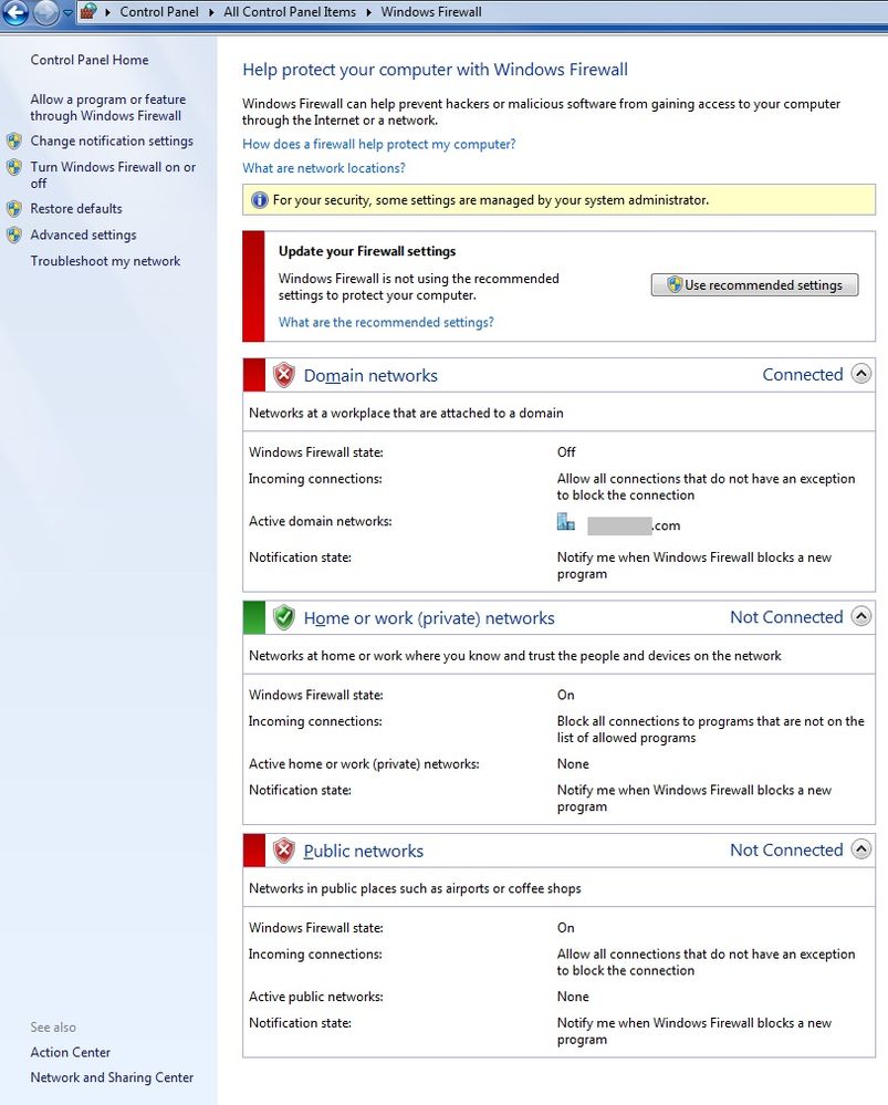

Try to open an Autodesk application on one of the client PCs. It might be necessary to open up relevant ports in Windows firewall (both on the server as well as the client PC).
I opened the firewall per the linked instructions.  Nothing on my screen matched what the instructions said would be there—is no "Inbound Rules" to select.
Message 25 of 32
Neptune48
Oh wait...I found Inbound Rules under Advanced Settings, just like the instructions said (D'oh!)

Okay, I went through all the steps, until I came to one that I don't understand:
Attention:
Please set all rules in the Client ports to All ports and the Server ports to  2080, 27000-27009, as the license tool on the client will use also other ports.
The server will always use b Default the ports 2080,27000-27009 unless you change the ports in the license file.

@Neptune48
You may not need to do anything with the firewall..
Is the license manager running and issuing licenses?   Check via service status tab and perform inquiry..
