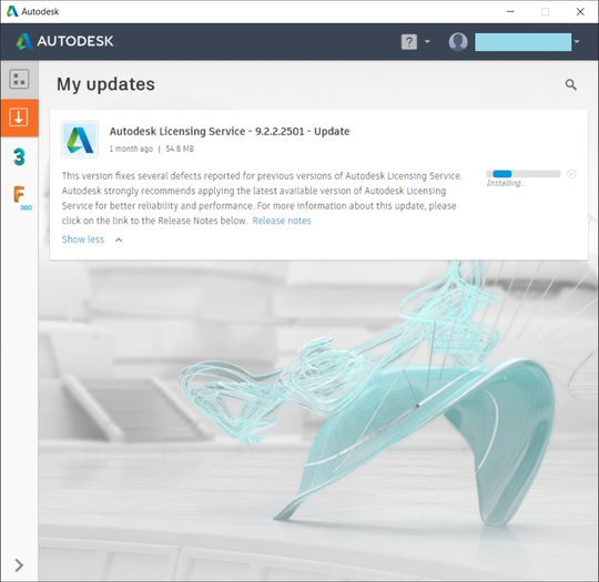

Message 6 of 9
Thanks @raiden_xavier  for quick reply.
following are the info you need.
1.  yes Update 2018.4 is installed
2.  just updated my license service to latest one. please suggest how to check
3. my graphic card details are
    NVIDIA Geforce RTX 2070 = 27.21.14.6172
4.  I downloaded the librarys from the link you provided and installed
5. flexNet service is running. I checked.
. net frame work 4.8 installed. which comes with windows. I cant uninstall it and try older one. no option to uninstall.
Now additional info. it was working fine previously. but suddenly stopped working.
ENU deletion also tried.
I did rollback to restore point. but couldn't help.
if I check product information and license information. it shows this white.
same white screen i see when it tries to show welcome in beginning. I turned welcome screen OFF by editing 3dsmax INI file but still not able to run max properly.
Please advise further.
