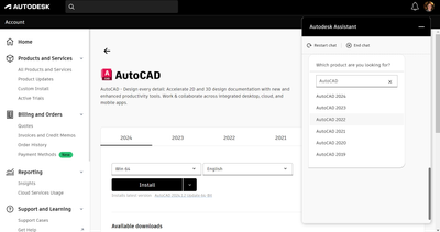

mdavis22569
You can get 2020 and 2019 via AVA in your account portal.  Go to the question mark in the lower corner. Put in Download, and you can get the 2 older versions.

Message 9 of 9
mdavis22569
Autodesk Assistant
12:01 PM, Nov 28, 2023
Hi! I can guide you to a solution or connect you with an agent.
What can I help you with?
Post-purchase support
Let's narrow your question down so I can show you relevant options. Select a topic below.
Downloads
Download software
  1. Your product might be missing from your Products & Services list in your Autodesk Account because:
    • Your subscription expired. To renew:
      buy online
    • This account doesn’t include the product. Sign in to a different account.
    • You are not assigned a seat. Contact your admin to request access.
    • Your purchase is still processing. For immediate access, we can help you download the product now.
  2. Find a product download
  3. Which product are you looking for?
Mike Davis
