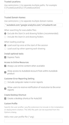

Just had a go using the new custom install tool to setup an AutoCAD 2022 deployment and as far as I can see there's no option to disable the Migrate Custom Settings that we used to have in the old deployment setup?
Old 2021
New 2022
Am I missing something or has that option been removed, or can the deployment it setups up be modified?

Not "out of the box", but it is possible to modify your deployment  for all your needs.
In the past the feature "Migrate" was disabled through the "setup deployment".
With 2022 you do not have the option to disable through a dialog, but you can still disable with a msi editor like orca or any other msi editor.
I did this just as an example, see the attachment (zip file you have to extract the mst file). And copy the file "MigrateOff.mst" to the same folder as the file "acadps.msi".
To "tell" the installer to include your new transform (MigrateOff.mst) you have to modify the file "pkg.acadps.xml":
Original:
installParams="ADSK_EULA_STATUS=#1"
New:
installParams="TRANSFORMS=%INSTALL_SOURCE%\x64\en-US\acadps\MigrateOff.mst ADSK_EULA_STATUS=#1"
That's all. With this "workaround" you can customize all msi packages as you need it.

Okay @jpCADconsulting ,
if you have blanks/spaces in your paths you have to mask / surround the paths with "quotes".
For your case modify the "installParams" parameter like this:
Before:
After:
installParams="TRANSFORMS=&quot;%INSTALL_SOURCE%\x64\en-US\acadps\MigrateOff.mst&quot; ADSK_EULA_STATUS=#1"
Try and let me know if it worked now.

Holy smokes it worked!!!
I can't thank you enough for helping me out - I was stumped.
