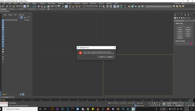

hey guys so here are some steps i have done
1. reinstalled different versions but max2020 more than 3 times clean installing
2. deleted / renamed the ENU folder, Plugins, UI, with no luck
3. Updated Autodesk Licensing to 2020
4. tried installing on my laptop with 100% success
5.Reinstalled Nvdia Grpahics Card Drivers
6. Should i reinstall windows ? but why when all my programs are working and i tried installing autocad and it worked fine so the culprit of this issue should not require me to reinstall right ?
what do i know ?
My system can handle this no biggie -> i9-9900k , 32gb ram , 1080TI
I made sure everytime i reinstalled it was a clean one
i made sure the flex servuces were running in the services tab
please help me as i need to use 3dmax for my college project 😕

michaelmagdy14
the software wont allow me to do anything once i open it
it freezes and just crashes as i have shown
