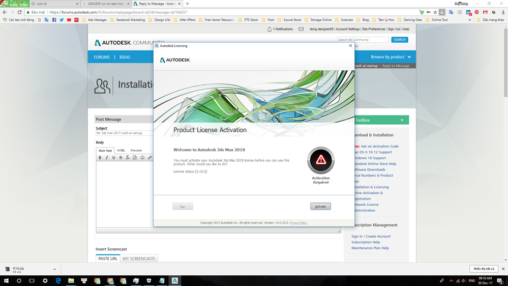

It's work for me - Win10 Fall CreatorIt's work for me - Win10 Fall Creator
I solved my problem with this Solution.
Thanks for help.
(using natashal84 method)
Note: if you have tried delete R14  folder and replace it with the new one. You will get script error notification. To solve that you need to take back your old R14 folder. Try it !
