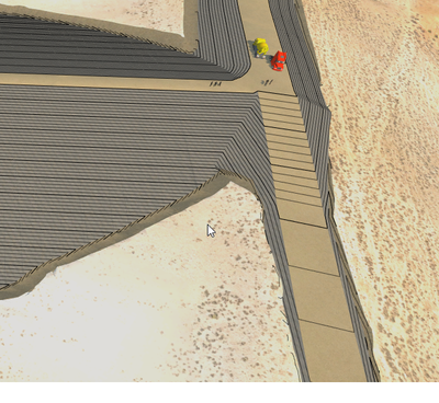

Yes.  I have nice screen presentation but it will not story board.
Screen:
Video (low quality on for test run):
I would just like the story board to record what is visible.
