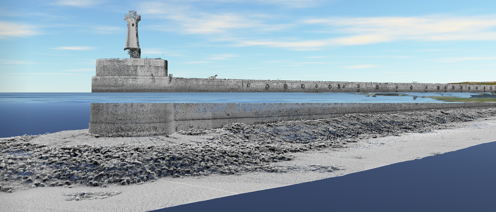

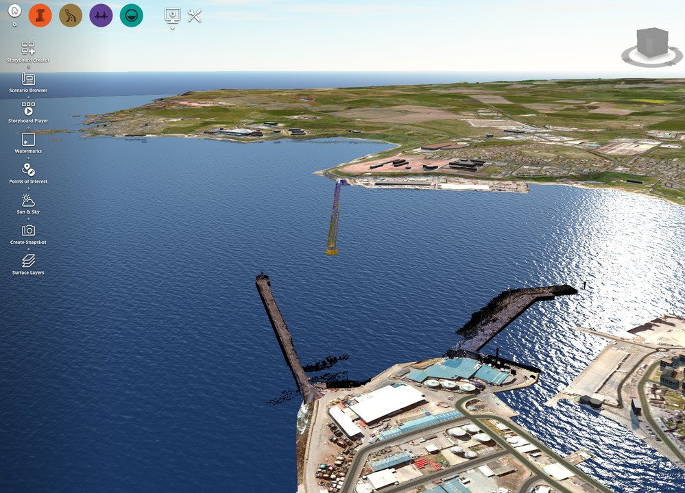

I work with point clouds all the time capturing marine structures and I would love to be able to (and allow my clients to) visualise there asset in context (ie infraworks) but
as some of those points are collected below the water level from sonar or subsea laser and as such don't have rgb values and are sometimes more sparse they don't display well with the basic colour elevation ramp without having shaders or ambient occlusion etc.
See this image I created in infraworks - the grey scale is the best but the detail would be better on all display styles with shaders.
I wondered if there had been any further intentions to implement shaders in Infraworks?
It is really lacking in the current versions and could bring a lot of value if added.
