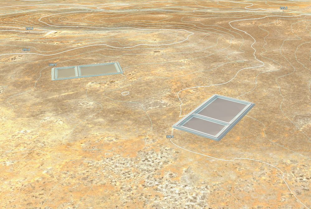

For example, this is the difference between a shared view and a infraworks view. The shared view is so sub par, its dark, it has no labels or vector features displayed correctly.
Infraworks Shared View (Contours, Labels and nice and bright)Infraworks Shared View (Contours, Labels and nice and bright)Shared view, dark, miserable, no labels, no linerwork, not usable for civil content)Shared view, dark, miserable, no labels, no linerwork, not usable for civil content)

@ceethreedee.com  Thanks for the idea. This idea is a group of multiple ideas. Visualization enhancements are implemented in the latest IW release. Other options in this idea are still valid and being tracked separately.
