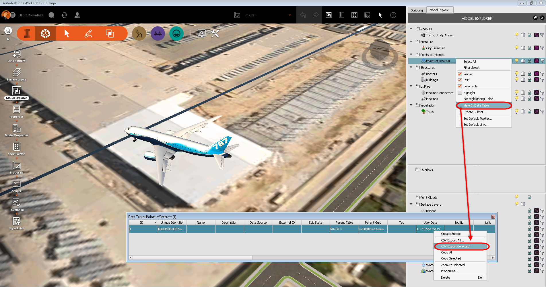

Say that you just used the script in this previous InfraTip ("Report Lat/Long/Elevation for a POI with a simple script"), and you want to report the attributes for a selected Point of Interest, or any other feature class, subset, or feature in InfraWorks 360, to a CSV spreadsheet. Here's how:
1) Add any data to a feature, feature class, or subset. You can do this through the Properties palette, the Scripting Console, the Data Table, or using feature asset cards. For the April 2016 release of InfraWorks 360, you can also use the Stack.
2) Open Model Explorer.
3) Select the desired feature class or subset.
4) Right-click and choose "View in Data Table"
5) Select the feature in the Data Table dialog.
7) Specify a location to save the CSV export. By default, InfraWorks 360 will use the location that the currently-active model is saved.
