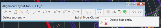

If you take a look at your alignment, there are elements like a half circle, this image is at the end of the first horizontal curve. These half circles caused some weirdness in your corridor.
You can delete them by clicking on the alignment -> edit geometry -> delete sub-entity.
I created a similar alignment with the same parameters as yours, the only difference was the corridor baseline aaand surprise: imported just fine both coverages and the road.
So, I suggest taking a look at the alignment EJE_2 and perhaps recreating it.

THANK YOU SO MUCH!!! I REBUILD ALL THE ALIGNMENT AND PROFILE AND IT WORKS! I THINK THAT IT IS A PROBLEM TO CREATE AN ALIGNMENT FROM AN OBJECT... I HAD TO DO IT MANUALLY BUT FINALLY IT WORKED.

GREAT!!! Glad to help. I noticed a lot of little tangents and curves with a small radius. WEEDFEATURES command may help you to reduce the number of vertices next time.
