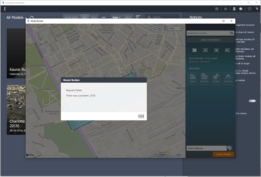

Hello There, Absolute beginner with infraworks here so be patient.
I'm attempting to use model builder for a select area that comes under the 200 sq.km limit. However when i select create model, i get the error code 210. I've looked at several forums and attempted to find a solution myself. However to no avail. I'm just looking for some advice or a solution to this problem,
Many thanks,
Rob

I have one more request to help us better understand. Could you please launch InfraWorks, then open Model Builder and take a screen shot of the entire Model Builder window?
Thanks so much!

I'm having the same problem in InfraWorks 2019.
Message 16 of 32
SethHall
Hi @JohnDutz
Thanks for reporting and providing a screen shot, it is very helpful. We are working on it, and I will update no later than tomorrow. Thanks again!

brian.babu
Hi @SethHall @Karsten.Saenger
Log Entry:
2020-08-19T18:31:54Z [15700]: d:\iwdrprod\git_source\desktop\source\alx\servicefoundation\serviceexception.cpp(55): error:
Service Exception: Network issues are preventing this operation. Try again later.
File Name: d:\iwdrprod\git_source\desktop\source\alx\servicefoundation\httpoperationbase.cpp
Line Number: 401
2020-08-19T18:31:54Z [15700]: d:\iwdrprod\git_source\desktop\source\plugins\dataservice\dataserviceplugin.cpp(255): error: Failed retrieving Bing key: Network issues are preventing this operation. Try again later.
2020-08-19T18:32:04Z [15700]: https://code.jquery.com/jquery-3.2.1.min.js(4😞 warn: [QT: js] Synchronous XMLHttpRequest on the main thread is deprecated because of its detrimental effects to the end user's experience. For more help, check https://xhr.spec.whatwg.org/.
2020-08-19T18:32:06Z [15700]: https://code.jquery.com/jquery-3.2.1.min.js(1😞 error: [QT: js] Uncaught SyntaxError: Unexpected token <
