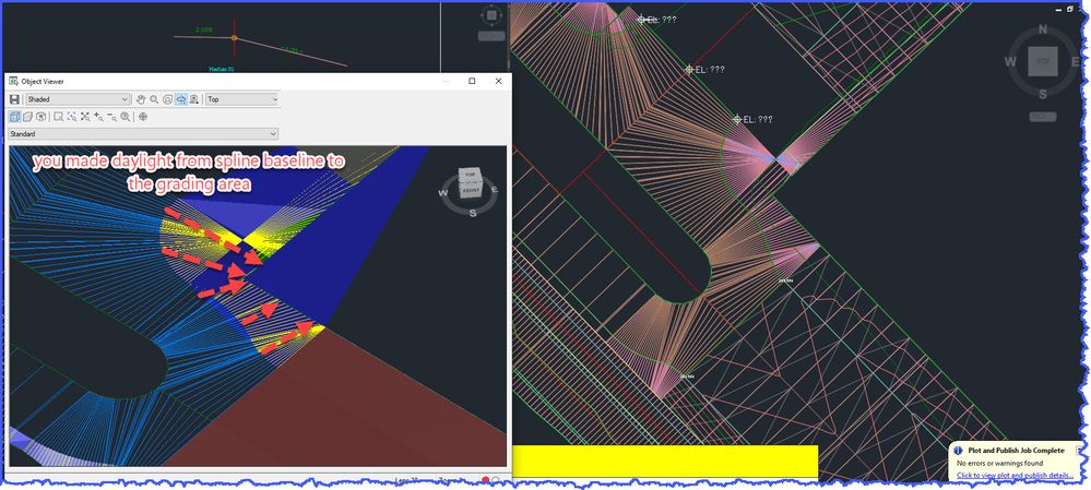

hamidatut72
The Median corridor can not reach to the selected target in the Pic. And Boewtiese resolve can not solve this

Beka_Tchigladze
so I modified your assemblies a little bit and create 2 from one as medina 011 median 012 after I add a small tiny fillet in the corner of the grading feature line after I target back to spline baseline you can review the corridor how do I modify.

hamidatut72
Thank you Very much. Good help. Now I can design intersections in a much good way.
