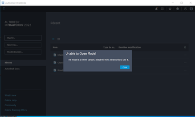

Hello, my colleague is trying to open an Squilte model I shared with here and she is getting this message.
We both have the most recent version of Infraworks and the model works on my desktop.
any ideas or known bugs that could explain this ?

Hi @Maher-Paul.Hamad ,
the message points to a version conflict.
Could you send the latest InfraWorks log file from your computer and your colleague's computer?
The log files are created in the folder: %appdata%\Autodesk\Autodesk InfraWorks\logs
Regrads,
Karsten.
