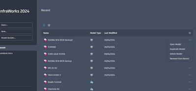

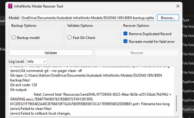

namlt33
Suddenly out of no where my model had went broke and now i have to rely on ModelRecover tool to access to my hours of work. But i dont qute figure out how to use it, the recover option is blur

Hi @namlt33 ,
the model isn't really broken.
The error message that is displayed states that a filename path is too long. So the overall path length exceeds the 255 characters limit.
Navigate to the model files folder "\Resources\LandXML\" and delete the folder  "97739458-8023-48ea-9b5b-a35133bdc7fd" - maybe better not delete it, but create a back-up.
This will remove the LandXML data source with the long file path. If this was the only issue, you should be able to open the model again and then reconnect the LandXML data source.
And - please change the model save folder to a local drive. Your model is located on OneDrive. This will lead to data corruption sooner or later, see https://knowledge.autodesk.com/article/Error-Unable-to-Open-Model-in-InfraWorks

Hi @namlt33 ,
you run into a "filename too long" issue, for example:
Resources/IMX/af115fca-a5f7-4802-b4ec-732da0ed88de/62D404.aecc.7B75B2EC88BA0386A089E81308BF8529.BF84BD57B0C82894C04227DDDEB9063D.B07EEF2EE7297ED02F818058AF699B1C.1700F24E72C7F5100142534D043AE6A1.6419CBF21A43D6D0C9B3449115586BF4.74468ADC6CE32322B58FB964332D3521.pnt': Filename too long
This is a known issue and is supposed to be fixed with the next update/HotFix. The issue is that the filenames for IMX data sources (for example all Civil 3D DWG added data sources) are doubling.
The only workaround at the moment is:
  1. Delete the subfolders in the IMX folder of the model.files database.
  2. Open the InfraWorks model.
  3. Reconnect to the Civil 3D DWG imported data sources.
(The path for local InfraWorks models is pointing to OneDrive/Documents. I suggest changing this to a local drive/folder to avoid issues with local models.)
