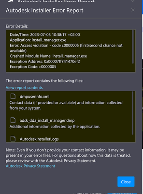

Hi @Karsten.Saenger
me and IT service have to prepare many computers
The solution you perpose solved the problem on many computers,
But on one computer, a new messsage appears, blocking installation :
Do you have any idea ?

Hi @jean-christophe_ouaknine ,
unfortunately, I don't have an idea what the issue is on this specific computer.
I suggest creating a support ticket for the Autodesk Installation Support. -> https://www.autodesk.de/support/contact-support
