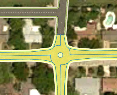

Is there a way to change the default roundabout type? I'm trying to convert an intersection in a subdivision to a roundabout but I keep getting an error that it's unable to solve the geometry. This is because it's trying to place a monster roundabout it a small residential subdivision. There is an option for a mini roundabout that would fit just fine but I can't do that because I have to create the roundabout first and then change it's type but I can't create the roundabout because the massive roundabout won't fit.

Hmm interesting... that is a good question. So I tried the same task you did and got the same results. The only way I was able to convert the intersection into a roundabout for this situation was to change the style type in the Stack to the FHWA-2010 Mini roundabout. Like you said wish we could set the default roundabout type maybe in the Model Properties, right under the road design standards.

So, how did you get it to do it then? I can't change it to a roundabout because the geometry is too constricting and the only way I can choose the type is after making it into a roundabout. Did you have to disconnect the adjacent roads first? Or did you do something else?

I got this message below. When I change the my intersection to the roundabout I got that error message and it change the intersection into none design road intersection. While the command was still active, I changed my roundabout to the min-roundabout. Please also note that I am using version 17.1.44.0 of InfraWorks 360.

Interesting. I'm using the same version but I'm getting a different message. What method are you using to convert the intersection? When I right click and choose "Convert to Roundabout", I get a message at the bottom of the screen that says, "Unable to Convert - Unsolvable Roundabout Geometry" and when I try to change it in the stack, it simply does nothing.

there is something wrong with the ix model. all boundaries of ix are incorrect those may impact it from being converted to roundabout.
log this as a bug, and will take a look internally.

The simplest workflow to get a roundabout at that 4 way stop, is to temporary remove (or move further away) the intersection to the left freeing up space for the new roundabout, convert the 4 way intersection into a roundabout, change the default type / edit the approach lengths to those required and then reinstate the removed intersection to the left of the new roundabout.
At the moment the "convert to roundabout" will always use a single set of defaults and this sadly causes some conversions to fail. I am not sure why nothing is happening when you attempt to do the conversion from the stack. On my machine, when running both the current released version and the sandbox versions of InfraWorks, I get the error warning both when using the right click menu and the stack.
