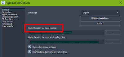

The model is hosted and stored on BIM360, so can't seem to find the model.sqlite and model.files folder anywhere I can access it (as far as I have searched). But I am very much interested in trying out the repair tool. Any idea where I can find the model folders? And how would you like to recieve the zip file?

All Bim360 InfraWorks models are cached locally. Open your InfraWorks application options to find the path on your system:
