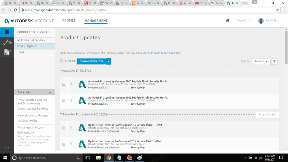

That's good news!! But now I am stuck on how to update - I see this dialog box pop up when I start solidworks:1.png
and when I click on it it takes me to this webpage, but there is no mention for an update of HSMworks on it.2.png
Do I just download the newest version of HSM online and my license should still apply?
