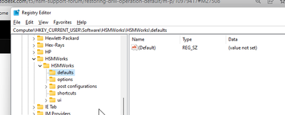

delete a "drill" from windows registry in Computer\HKEY_CURRENT_USER\SOFTWARE\HSMWorks\HSMWorks\defaults
roger
I couldn't really follow that path reference. I don't see anything similar on my computer. I take it there is not a process within the open Inventor application?
jeff.pek
To get to that area, you need to open the Registry Editor (RegEdit) app. It will look something like this:
