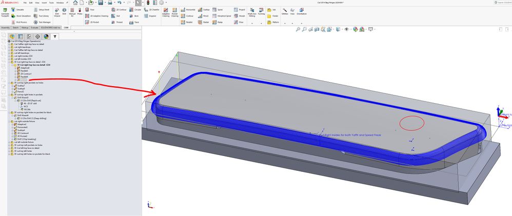

Making a very simple part, but has to have radius on perimeter.  Using a corner-rounding endmill is not an option due to the mounting screws. So I chose a 1/16th BEM.
The path on the "Back" came out fine. Smooth, consistent, all linked together, all correct direction for climb cutting finish.
The path on the "Front" however, which was a copy/paste from the back, then I picked the "front", in order, just like I did with the back section, and this is what I get.
Split/broken links, lots of unneeded tool raises and air movements.
All the path specs are the same. But its giving me an Undesired toolpath.
Changing the tangential extension has no effect. Still splits up the path.
I tried deleting it and starting over, re-picked the arrows, and still, same thing.
Anyone know WHY???

Not sure if IVCAM has BLEND? it is in both HSMWorks and Fusion 360.
Blend allows you to pick a slew of edges and faces to cut them in one path, might be in BETA Mode like in HSMWorks.
I use it all the time for exactly what you are doing, Flow is for single faces where BLEND is for multiple string of faces.

Having a Blend path would be great, but currently, Inventor 2024 CAM does not offer it.
ckautz
Go to CAM ribbon, "Options", in Licensing, there is a Button "Feature Flags..."
Select that, and enable Blend
Then in 3D Milling, it can be selected
