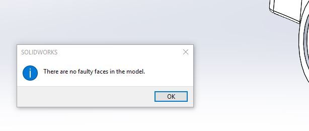

I keep getting this error after updating some geometry on the SW part. The file is an SW file that I had already machined but came back to make some changes to the geometry and now it won't generate. This only happens on the "Flow" operations or "Scallop". Adaptive, Contour, Pocket and Face operations updated fine. It happens on new operations of Flow as well. I even saved the part as an .XT file then imported and tried again and I still get the error. I opened up a different file with flow operations and it seemed to work fine. I have HSMWorks 2018 R1.

Hi @Anonymous
I'm sending you a file about this error. In SOLIDWORKS you can easily see which surfaces are faulty using the macro command. Could you give it a try?

Message 5 of 22
Ran it on the assembly and the individual part and it says its okay:

Hi @Anonymous
Can you  save it in different format and try again ? For example (x.t, iges, parasolid, acis)
Best regards,
MEHMET CAN YILDIRIM
Message 7 of 22
It doesn't not work if I save as an .XT import than save as a Solidworks File, but it does work as an IGS and saved as an SW file. I didn't want to have to do this because I lost about 8 hours of programming but it is what it is. I have also been in contact with Autodesk Tech Support and the said it was going to go to their developmental team to find the root cause.
