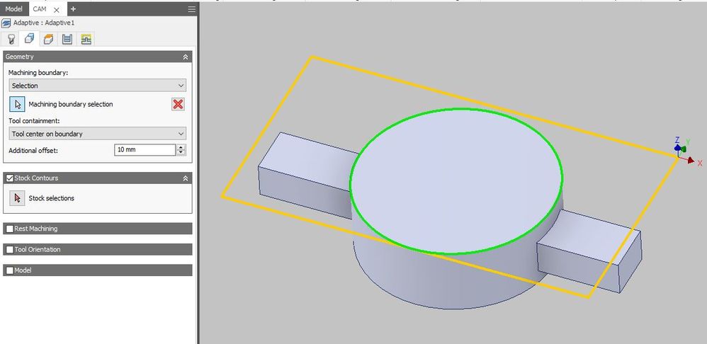

Hi there. I'm a recent convert to SolidWorks and I'm trying to use HSM Express as my CAM package. I've been trying to set up a milling operation for what I believe should be a very straight forward task, but I've been unable to get the behaviour I want.
To put a long story short; I'm preparing to mill a two sided piece, and I'm trying to set up a contour operation that would cut the outline of a main part, but leaving several tabs to retain the cutout fixed inside the stock. To illustrate my problem, I have attached a very simple part that exemplifies the problem I'm having. Please keep in mind this is not the part I'm actually trying to mill, it is a simplified part that should illustrate the problem.
What I want to do is to contour the cylindrical part out of the stock, but leaving the two tabs in place, but I've been unable to come up with a path that does this.
To give you a bit more background, the "full" problem I'm trying to solve is to mill the contour of a guitar body, represented in my example by the cylindrical solid, from a large rectangular stock, but leaving tabs/bridges to keep the body fixed, as the stock will be fixed down at the edges and I don't want the cut out piece to go flying across the room. Since HSMWorks/HSM Express doesn't seem to support tabs, I'm trying to manually model them, and then trying to prevent HSM Express from milling them away.

Like the image below?

You need to create a containment/boundary for the tool path to work with. I just used a large circle in the example. Hope this helps.

Are you using a 2d contour operation or is this a different type of operation? Because I'm not sure how I tell HSMExpress to respect the boundaries of both the cylinder and the tabs. Whenever I select the cylinder's edge, it would always try and cut out the entire cylinder, cutting through the tabs.

I'm using Inventor HSM with the adaptive clearing cycle (3D), the yellow is the stock contour, the green is the boundary selection (top edge of the cylinder) with a 10mm offset. No other geometry is required to be drawn unless you need it.
Image bellow is the simulation.
Hope this helps.
