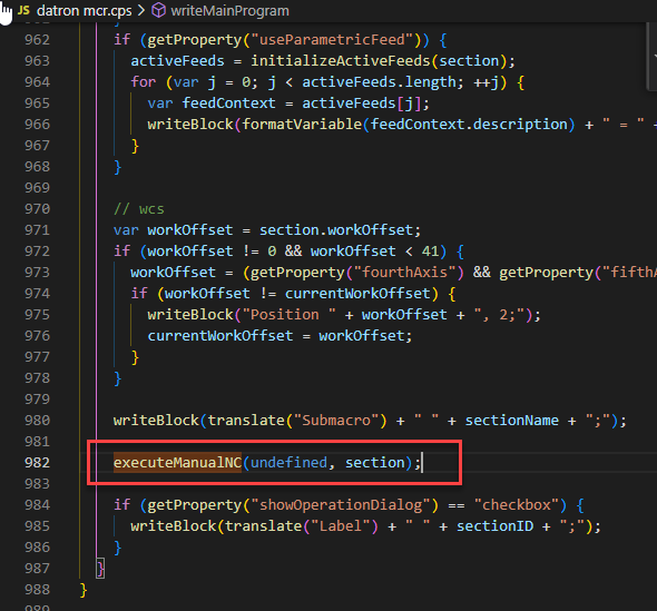

Ok, then please add the following code to your post:
var manualNC = [];
function onManualNC(command, value) {
  var section = typeof currentSection == "undefined" ? getSection(0) : currentSection;
  manualNC.push({command:command, value:value, sectionID:section.getId()});
function executeManualNC(command, section) {
  for (var i = 0; i < manualNC.length; ++i) {
    if (manualNC[i].sectionID == section.getId()) {
      if (!command || (command == manualNC[i].command)) {
        switch (manualNC[i].command) {
        case COMMAND_BREAK_CONTROL:
          var upperTol = xyzFormat.format(toPreciseUnit(0.05, MM));
          var lowerTol = xyzFormat.format(toPreciseUnit(0.06, MM));
          writeBlock(translate("Tcheck") + " 0, 1, 0, 0, " + upperTol + ", 0, 0, 0, " + lowerTol + ", 0, 0, 0;");
          break;
        default:
          expandManualNC(manualNC[i].command, manualNC[i].value);
  for (var i = manualNC.length - 1; i >= 0; --i) {
        manualNC.splice(i, 1);
and add this code into the desired place where you want the manual NC code to be output:
executeManualNC(undefined, section);
With your example, you may want to place the executeManualNC call to the writeMainProgram() function at this place:
Achim.N
Principal Technology Consultant
Message 15 of 18
U.Uhl
