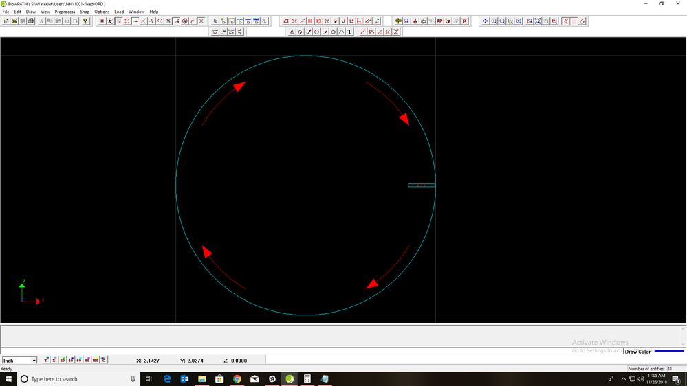

Trying to open it in the Flow software gives an "Incorrect file format" warning, and won't open it.
After I edit the first line to this:
// This file was created by FlowMaster(R), which is proprietary to Flow International Corporation. 7 4
It will open in Flow, but the path is incorrect:
If I move the arc center coordinates up a line, it generates the correct path:

It seems like a simple fix , but I don't know post processors or JavaScript well enough to fix it myself.
Can anyone help?

dwruss01
Just to confirm, I used the post I had put up a few days ago.
You will find the .ord file attached along with the .f3d so everyone can see what was going on.
The .ord file that was output from Fusion worked without any problem on our Flow Mach 2
@Anonymous, I am not sure how big a file was used that gave you problems. If I come across a file that this post-processor gives me an error on, I will post back on this thread to let everyone know what I have come across.
