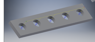

I would like my Haas code to be created with one sub routine that is called up for each location of that same feature like is explained below. I downloaded the Fanuc.cps post and ran code but the code still reflects all 5 of the same holes in the sub routine instead of one sub at 5 different location.  Not sure what I am doing wrong..
Message 23 of 25
bob.schultz
Subprograms only work with patterned operations, so you need to select only the first hole for the operation and place it in a Linear Pattern to get the post to output a subprogram and a call for each hole.
