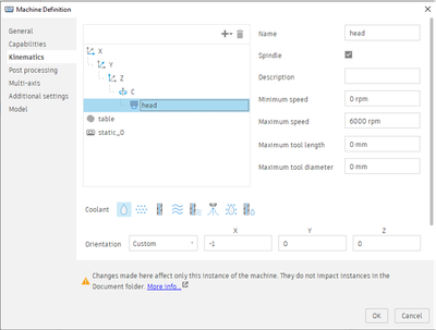

You can set up the machine definition here by adding rotary axis and entering the correct orientation vectors for each position. This ensures the tool aligns properly with its default (C0) position. For example, if the tool’s C0 position points from the origin along the positive X-axis, set the “head” vector to match that direction, as shown in the screenshot below.
To generate NC code, you can use a generic post processor like Fanuc, provided it matches your machine’s NC code. Alternatively, you can select a suitable post processor from the post processor library.
