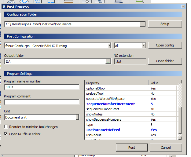

Like the title says. I have a Miyano BNC34T (1985)
It utilizes a simple Fanuc 3T Control.
Has a RS232 serial port. I have made the switch from a popular CAD/CAM software wich ryhmes with the latter part 🙂
Will the Generic Fanuc Lathe Post Processor output the correct G-Code?
I have already noticed, it continually sets my G50 at 6,000 even if I have the CSS set at 3,000 or If I disable use CSS it still sets the G50 to 6000 even if my spindle speed is 3,000. Guess if I have CSS disabled it's a mute point.
Anyhow, this is my first post and most definitly not my last.
Any help would be appreciated.

HughesTooling
On the post dialog under Properties look for the option maximumSpindleSpeed and set it to 3000.
Another option to might need to experiment with is type (options are A,B,C), for my 210iT I need to set it to B to get the correct format for threads, setting the spindle max speed, etc.
Mark
Mark Hughes
Owner, Hughes Tooling

Additional Quirks
1. Under Cam I have Selcted "dont go home"
2. I also have selected "feed per revolution"
Yet when I PP the Tool Paths, I keep getting a G28 U0 at the end of each operation
I also get a G98 at the top of the Processor?
This is Using the General Turning Fanuc PP Model A (I did try changing to B, and that cleared the G98, But not the G28 U0)
O1001
N10 G98 G18
N11 G20

George-Roberts
That will be hard coded.. Are you using the generic Fanuc turning post? If so, have you tried changing the type in the properties? The G98 G18 only appears if Type A is selected, see the code below;
  // absolute coordinates and feed per min
  if (properties.type == "A") {
    writeBlock(gFeedModeModal.format(98), gPlaneModal.format(18));
  } else {
    writeBlock(gAbsIncModal.format(90), gFeedModeModal.format(95), gPlaneModal.format(18));
This basically says, if type A is selected, output: G98 G18. If the type is not A, output: G90 G95 G18. Would this be a better fit for your machine?
The following code is what is causing the G28 U0;
  if (insertToolCall || newSpindle || newWorkOffset) {
    // retract to safe plane
    retracted = true;
    writeBlock(gFormat.format(28), "U" + xFormat.format(0)); // retract
    forceXYZ();
This will check if there is a toolchange, new spindle or a new work offset.. If any of that is true, the software forces a retract with G28 U0.
Hope that helps!

George-Roberts
I would keep the G28 U0 if your machine accepts it (I thought all FANUC controlled lathes do). This will move the machine back to its absolute Z0 prior to a tool change.. Last thing you would want is to change tools when your only a couple of mm from the job...
You could probably change it to G53 Z0 if your machine accepts it? Your programming manual should give info on this.
