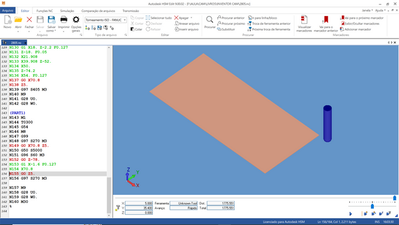

If in Setup> Select I change to Generic Mill-Turn Lathe and then configure the Post Processing in Edit>Machine Configuration for fanuc turning.cps, the error does not occur, however, when generating the NC program it is generated with a milling tool in Autodesk HSM. See the figure below.
And all tools configured for turning disappear.

With the update to version 2023 and rebuilding the setup without selecting the machine, it was possible to generate the G code successfully. I am gratefull for that.
Some other issues need attention:
The stock size defined in Inventor CAM does not persist in Autodesk HSM.
Tools configured in Inventor CAM do not persist in Autodesk HSM.
I don't know if any configuration is required to succeed with this.
