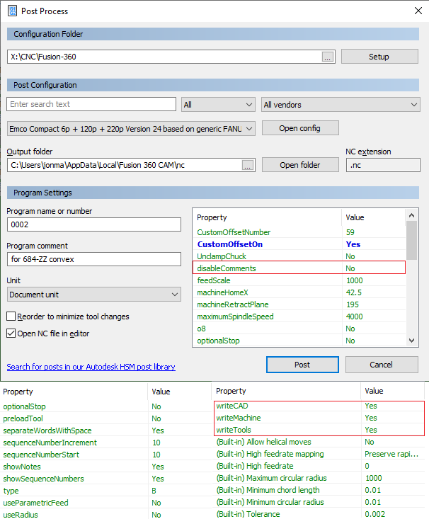

Message 31 of 41
DaneelSE
Some more formatting changes
I moved the output of the cad data to after the program start.
I added option to disble parts or all of the comments as seem to generate issues for some. image.png
I also added code to prevent work offsets above 2.
Let me know if there is anything else we need to work on.

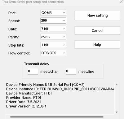

I just bought an Emco 220p and was wondering if anyone could recommend a USB to serial adapter + cable?
Which program do you use for file transfer?
Thank you tom
Message 36 of 41
tom_bresenhuber
So, I have some form of communication working. If I send data from the EMCO to the PC, it works perfectly, but the other way around, it doesn’t.
I am transferring data using Tera Term with the following settings: 300 baud, 7-bit, even parity, 1 stop bit.
On the EMCO, the settings are:
  • O.00 = 4 (I also tried 0 and 1)
  • O.01 = 121
I have already tried various combinations, but either I get ERROR 600 or nothing happens, and the number 053248 is displayed on the screen.
What settings are you using? And what cable setup do you have? (I have only three pins connected: 2-3, 3-2, 5-7).
Please HELP!
Message 37 of 41

Message 39 of 41
tom_bresenhuber
Thank you for the response, i checked the cable and it should be the right one.
What program are you using for transferring the files? TeraTerm, Hyperterminal,...?
What are your settings?
Message 40 of 41
EmcoAlex
you need a cable with profilic chipset
 StarTech.com 1 Port USB auf Seriell RS232 Adapter - Prolific PL-2303 - USB auf DB9 Seriell Adapter Kabel - RS232 Seriell Konverter (ICUSB232V2) https://amzn.eu/d/de4M9bB
i use this. original this blue from startech.com bought at amazon.
you need more then tx rx crossed. you need the handshake. buy this cable and then i can help you to setup teraterm and your machine.
ok?
i forget!!!
you need male db25 and female db9 connector.
you must solder a converter.
i can help you for this. easy job.
