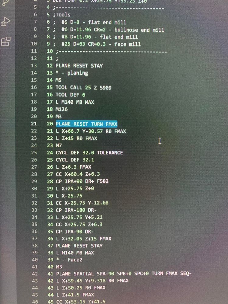

Hi. I have been using fusion 360 for a few years now for our machines and it works super well. we have now bought a DMG Monoblock 75 with Heidenhain 640 control. The little I had time to test, it seems to work great with generic post for heidenhain, but I have a small problem I would like to solve.
when posting then I would like it after each tool change or operation do a spatial move. post a picture with what I mean. the reason is that if I probe a plane that is not straight, I do not want to think about always handwriting it before i start. is there anyone who can help me modify the post?
sry for my bad english.
What a want it to post the next line under PLANE RESET TURN FMAX
