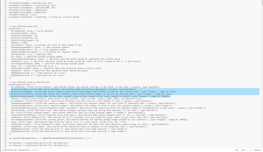

First, add this code under the //user-defined properties. These are the items that show under the menu in the post window, and the values you enter here are the defaults. See image 1
  barPullerEnable: false,
  barPullerToolNumber: 06,
  barPullerToolOffset: 06,
  barPullerStockLength: 48,
Next, enter these under //user-defined property definitions. Description is the tooltip that pops up when you hover over the menu item, the type is if its a number (integer), string , etc. See image 2
barPullerEnable: {title:"Bar Puller Enable", description:"Adds Barpulling subprogram", group:0, type:"boolean"},
  barPullerToolNumber: {title:"Bar Puller Tool#", description:"Tool Number (and offset) to use for Bar Pulling tool", type:"integer", range:[0, 100]},
  barPullerToolOffset: {title:"Bar Puller Tool Offset#", description:"Offset Number to use for Bar Pulling tool", type:"integer", range:[0, 100]},
  barPullerStockLength: {title:"Bar Puller Stock Length", description:"Length of bar stock length in inches", type:"integer", range:[0, 10000]},

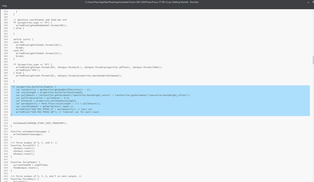

Next up we will add our macro code in the program heading. Here I used #501 as the part quantity, how many parts we will make each press of cycle start, and #502 is how many parts the machine has made or looped. You want to add this before we write N01, so that your part count doesn't get set to 0 every loop and run until the power goes out.... search for any code your post puts before it writes the code for the first tool... perhaps search " writeln("O" " , and add someplace shortly after. See image 3
 if (properties.barPullerEnable) {
    var lastSection = getSection(getNumberOfSections() - 1);
    var stockLength = properties.barPullerStockLength;
    var pullAmount = lastSection.getParameter("operation:backHeight_value") + lastSection.getParameter("operation:backHeight_offset");
    var pullFromLocation = pullAmount - 0.4;
    var minStock = properties.minimumStockLength;
    var partQuantity = Math.floor(stockLength / (-1 * pullAmount));
    var stockDiameter = getWorkpiece().upper.x;
    writeBlock("G65 H01 P#501 Q" + partQuantity); // part qty
    writeBlock("G65 H01 P#502 Q0"); // internal var for part count
