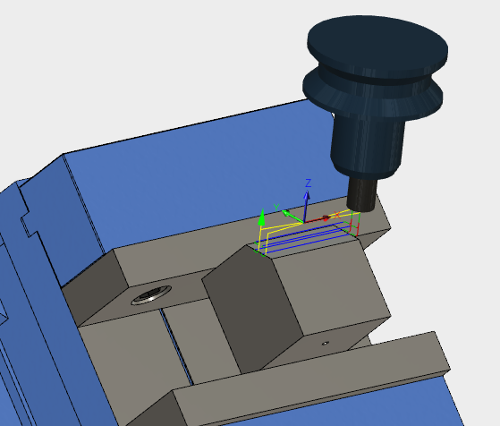

Had some free time today, so I decided to see if I can't get this working. I ran a simple operation.
Here is the setup:
Here is the operation:
It's a 2" Cube. I set G54 to the back center of part, Z0 on top of PC as shown in first image. I then created an operation to mill the 45° chamfer. I used tool orientation to setup rotation.
When I first ran it, the table did not tilt. I added P1 after the G68.2 and that fixed that issue.
But, something is definitely still off. The tool started way out in front and way off to the left of the part. It should have started to the right of the part as shown in image two.
Any thoughts on this?

Well I think the 0i-MD doesn't do 5-axis simultaneous if I do some googling.
But the 3+2 with tilted work plane is a plus. I'm pretty sure this means we can actually place your workoffset anywhere you want and use the G68.2 code.
So if you set up the correct machine configuration you should be able to try out the the code on your machine.

Laurens-3DTechDraw
Might be good to ask them about this.
Since I'm pretty sure the code is correct, but I'm not sure if they set-up the machine correctly for it.
They can probably also tell us what is wrong when the code does turn out to be wrong.
