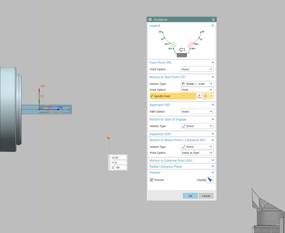

@Lonnie.Cady If you have individual control over the initial plane for each operation, and you could control the order of movement from that plane to the start position and back say, X->Z, Z->X, or X+Z at the same time, etc) would that still meet your needs? I ask, as this would have the potential to push more stuff out of the post and into the actual UI, which I think is always a huge win for everyone.
FWIW, this is definitely a place where NX seems to have some sound logic. You can define your initial (avoidance) position via a point along the X/Z plane, and then define the motion logic for basically every move it would make from or to that point (to part, from part, from avoidance to home, from home to avoidance, etc..) - Its defined as a piece of geometry, and every operation can have one attached to it. The same avoidance can be, and in most cases is, reused for many operations. nx_handling_this_like_a_boss.PNG
And with this, the work is kept in the UI and not pushed into the dark depths of the post processor. I don't know that it's a 100% perfect solution, but it's certainly capable of handling all contingencies, which I don't think is accurate of the current method in HSM.

@Rob_Lockwood I think that is a great idea.  I was thinking a similar idea but was not sure it would not just clutter up the UI.  I think the method you outline offers much more control than the post processor and also allow for better simulation to show the proper moves vs them being separated in the post processor.
One thought though is that what we are talking with how the tool moves before/after the operation may not make as much sense on the Geometry tab.  IMO the geometry tab is were we either override the model selection or set the confinement to limit what  geometry the kernel sees for tool path creation.
How the tool moves between to and from an operation almost sounds like linking tab stuff to me.  I would be fine either way.
Another thought is that it appears as thought in NX you are specifying a point.  In HSM turning products that point would be derived from 2 different tabs.  The Height tab and the Geometry.  It would be nice if they could show a graphical point on the screen as to where the intersection of the Radial and Axial clearance is since the are only visible while the tab is active.
I think HSMWorks had some better visual indicators than the current HSM Inventor or Fusion.

Right, in NX, confinement applies to both axial and radial, and they're
defined much like the current confinement in HSMWorks, though a box exists
for both a min/max radial, a min/max axial, and two more that i'm not
entirely positive what they do 🙂
The page I showed covers 'avoidance' - and it's entire purpose is to define
how the tool moves from operation to operation, in essence, linking.. but
there's some inevitable crossover in there someplace no matter how you cut
it.
