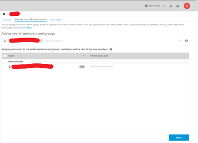

Hello, I am trying to add another member to a project of mine, and I am one of the admins. However, when I try to click "Done" after the following:
I get the following warning:
Following which if I click "Proceed", the member I am trying to add does not receive the email.
When I try to update the permission level of the new member, like below, I cannot see any option to do so:
What can I do in this case?

Hello @h1 ,
As per the image, you have "Basic Access" in the hub. User with "Basic Access" cannot invite user, assign/change roles of user in Project/folder.

h1
To everyone who replied to me:
I have tried click on the role to give permission already, but only a blank menu opens up for me on the right, as seen here:
Could this be because my account only has basic access?

In Images you shared, we can see you have Basic access license for Fusion application. With Basic access login you can do limited activities only.
Message 14 of 15
h1
Ah okay, I am trying to give access to my other account which has educational access, but this current account doesn't. Is there any other way to add a new member with just the basic account?

Hi @h1
Invite this user from hub and promote the user to Team Administrator. Then this user can manage permission in the project.
Help document link to Invite user to hub and changing hub Role: https://help.autodesk.com/view/fusion360/ENU/?guid=GUID-C44BE511-2BD2-44EA-878F-A27C2357BD5D
