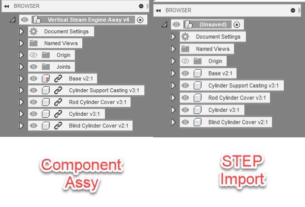

Hello, When I export to a STEP file, all of the Names for each Body are gone, and the individual folders are gone as well. It is just one folder with a list of Bodies in numerical order. Is there a way to export to a STEP file and maintain the body names and the folders they were in?

If your assembly is composed of Components, a STEP file export will maintain the names of the Components.  I am not quite sure what you mean by Folder?

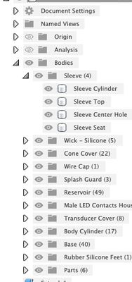

Here's a screenshot from the Original Project File
Screen Shot 2021-11-15 at 2.45.30 PM.pngAnd this if from the exported STEP file

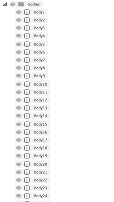

pangelotti
Update.  I created components, and those Component Names transferred.  But the Bodies that were named under those components are generically named Body 1, Body 2 and so on.

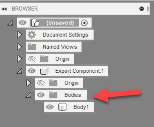

I do not know anyway of retaining the Bodies names in the STEP file export.  I see what you are talking about when you mention Folders.  Bodies are grouped using folders and as far as I know these folders are also not copies when exporting to a STEP file.
Correction: The Body folder is retained, under the component, but the Body names are lost.  Below is a screen capture from a STEP file exported from a Fusion 360 file containing Components.
