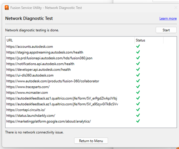

Blank screen no matter what. At best time I managed to got into the UI and then the software just crashed.
"can't find a solution" is what I got from the crash report.
Software were stable few updates ago and now I can not even ask my manager to renewal it since this is no usable .
So far tried:
Uninstall and reinstall 50 times at least
Restarting PC many times.
Tried updating graphic card driver many times, tried different versions. (RTX4080)
Tried clean install with all hidden folders deleted 10 times.
Tried Registry deletion many times.
Tried every single function on the utility tool.

@weihao_wei Can you also try another workflow?
1. On this same machine quickly create another admin account and Install Fusion there and see if it launches successfully?
2. On this current install, if you right click on the launcher and do a "Run as Admin" does it make any difference?
3. Is it possible that a Windows defender settings or firewall block could be stopping the software from running?

Network seemed fine

Message 8 of 17
Not working at the moment
It should not be because the app were running fine 2 weeks ago before the update, been using the app on the same PC for 2 years.

Message 11 of 17
Oh crap! reset the firewall and now the personal account can be entered.
I can open file now.
Only thing I noticed
This area is blank
Message 12 of 17
Alright firewall reset did something (Autodesk service are all allowed)
Trying the commercial account now, I know it is trial for now (if it works then yes I can request the purchase)
Commercial account stills shows blank screen, but the utility tool is working now
here are the automatic generated files.
Hopefully we can know what happened!
