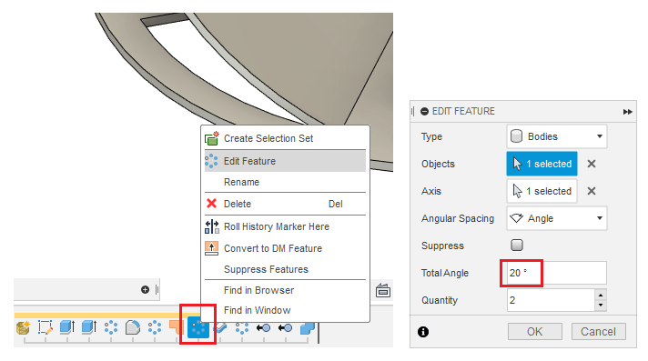

Can you suggest some tutorials close to how you did this fan blade? I really would like to know how to change the angle if I wanted it steeper?

I can record a screencast of how I did in my files. But also you can simply roll back my timeline all the way, expand Sketches and Bodies folder in the Browser and unhide everything, and roll history marker one by one to see the steps (well after writing I decided to record this, take a look, I hide mesh body for better visuals). However, if you are new to Fusion 360 (and CAD in general), I suggest first watching basic tutorials of Fusion 360 (e.g. Self Paced Learning from Help menu). Once know the basics of modeling it will not be hard to model on your own.
@oxicottin wrote:
... I really would like to know how to change the angle if I wanted it steeper? ...
For this you can edit the 3rd Circular Pattern in my timeline of Blade 2 (or bend angle in Blade 1 file):
