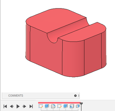

It's the draft command that does it. Here's the simplified timeline.
Without the draft command the work plane does not flip.
Workarounds
1. Place the work plane prior to the draft.
2. Or just supply a - sign to flip the resulting angle in the model attached.
(FUS-107663)
